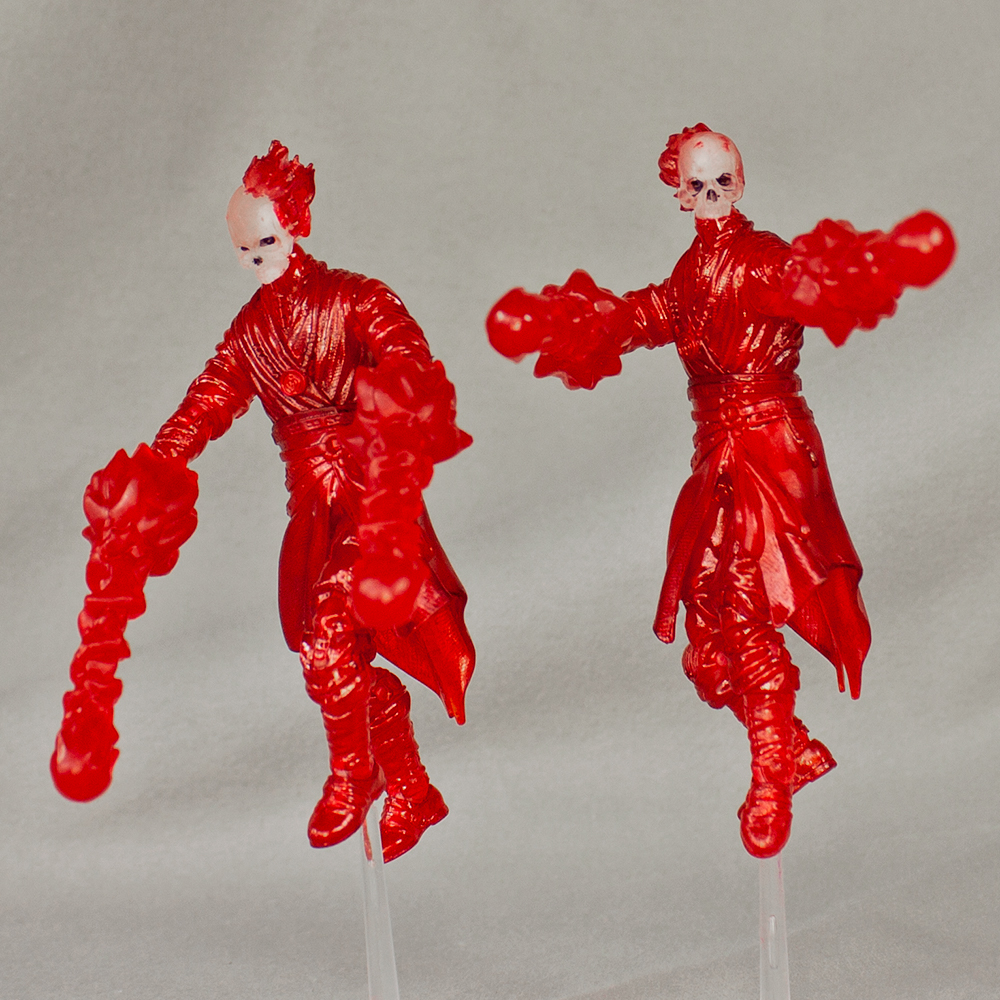

It should work. Be aware a number of years ago RIT changed formulas and the regular RIT Dye doesn't work on plastics. I believe RIT Dyemore should work. Start with a little so it doesn't go too dark and ruin the translucency.
Also, if you can be patient, I've had a little luck with Sharpies on translucent figures. If you can find the "brush" style sharpies in the color you want, and give it plenty of drying time, it's another option though not as clean a look.
These were done with Sharpie.

Those are amazing.
