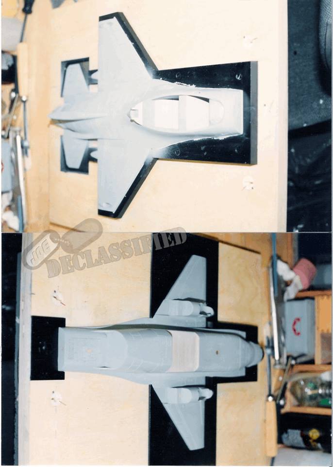

Carved wooden vehicle pattern of the underside of the Ghostriker jet
Blueprint drafts
Individual part patterns
Ghostriker patterns in their tooling frames
Zanzibar skiff in its tooling frame
