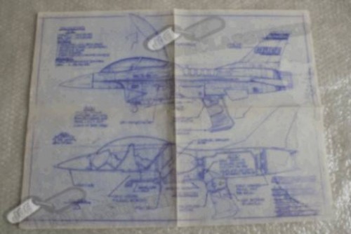

The Designers would then take that model and draw up blueprints as to how the finished product should look.

Remember again, this was before Cad and the compound curves developed on a toy would be near impossible to create in a standard three view drawing on a drafting table."

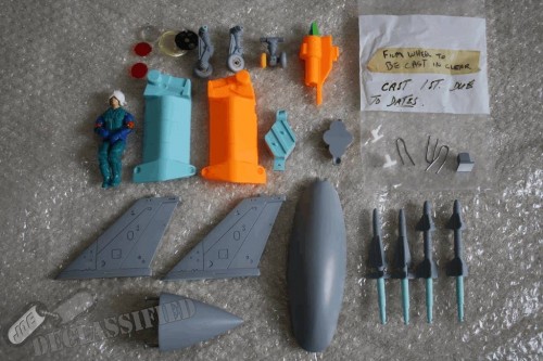

Carved wooden vehicle pattern of the underside of the Ghostriker jet

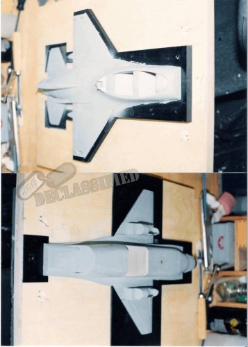

Blueprint drafts

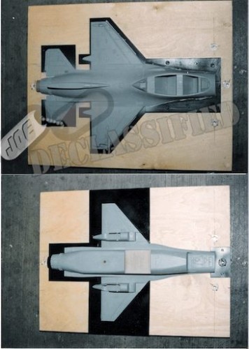

Individual part patterns

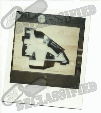

Ghostriker patterns in their tooling frames
