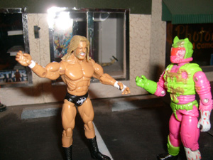

they're main problem (And the thing keeping me from buying more of them) is that they are NOT 3 3/4" scale. They are way short of Joe height. They look like midgets next to Joes and especially bad next to 25th Joes.
I have to disagree here too, they look great with RAH figs but they are short compaired to 25th (as are RAH figs are too.
Included photo of Toxozombie and Triple H (from an upcoming project I should be posting soon :shifty: )
My main problem is that there is no scale in the line, in other words Undertaker is the same hieght as Cena ect. that just bothers me a bit (and prevents me from picking up taker and the taller wrestlers).
