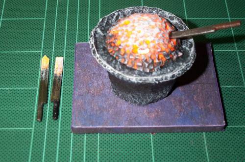

A nice set of makeup brushes will do wonders too. The bushier the better really.
I am using it lately to convey the ash and smolder of hot pokers used in old style torture:
