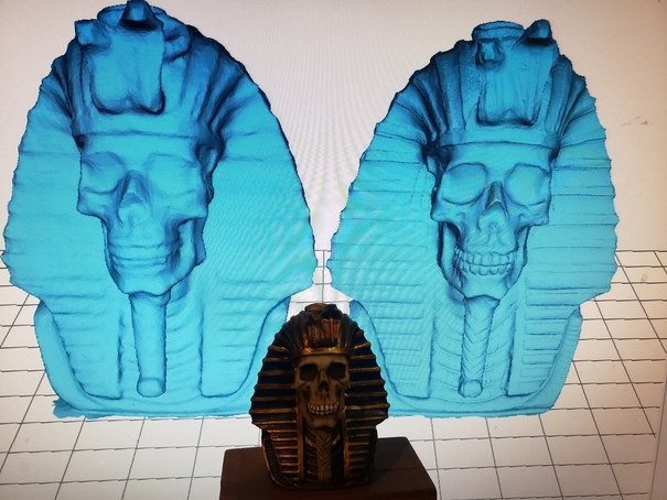

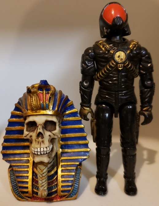

I have had some great results messing with a free photogrammetry program https://www.3dflow.net/3df-zephyr-free/.
 Post subject: Re: 3D printing/scanning advice?
PostPosted: Sun Nov 01, 2020 7:49 pm
Unfortunately I forgot these results were gotten with Autodesks long discontinued 123d catch. I'm still trying to figure out 3DF Zephyr, and while I have gotten some promising results I haven't gotten anything as crisp as this one yet. I just wanted to show that it is possible.
The one on the left was the initial result, and the one on the right after I applied the texture to the surface.

That's really impressive. How large is the original object?

Yeah, 123D Catch was very good. 3DF Zephyr is good but the free version is limited enough that it can be difficult to get decent results with it. You're limited to 50 pictures. That's usually more than enough for a decent scan but can be difficult if it's an object with a lot of detail. I really wish Autodesk hadn't dropped the 123D line. They were great for hobbyists.
