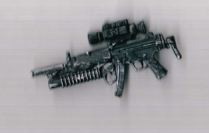

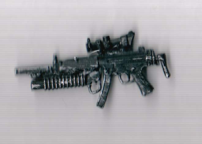

Don't know about MJ's M203 and his MP5 but here's the one I did with the BBI ones. Might give you some ideas anyways.
