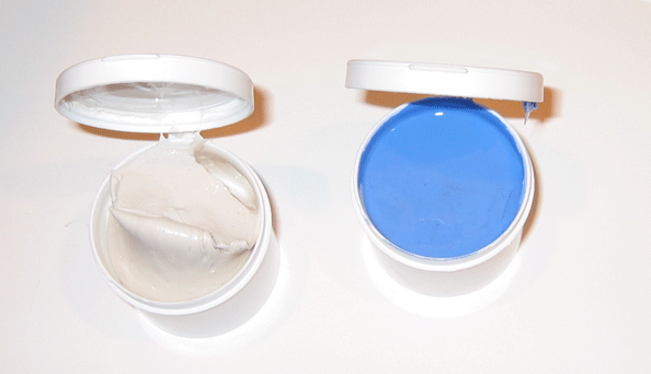

so, i ran across this product in another forum - i think it was Craft.
anyway, it's a two-part flexible mold making system from TownsendAtelier.com called Knead-A-Mold.
for anyone familiar with greenstuff, this is old hat.
I bought the 'starter kit'
I've just started with this stuff tonight, with a HISS Driver Head and Snake Eyes/Kwinns' Skull Necklace.
I'll start posting the results tomorrow.
here's the 1st shots:
ps. the same company sells resin/plastic --
