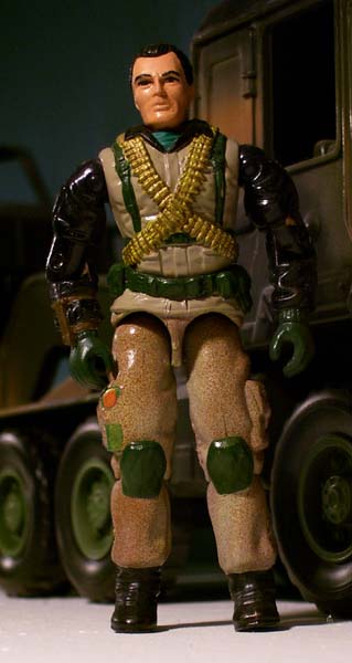

Chryslophylax, I'm curious to try the black-under-gold technique. Sounds cool.
Remster_9, here's an image of a custom figure, "Open Bolt", using yellow-under-gold...
