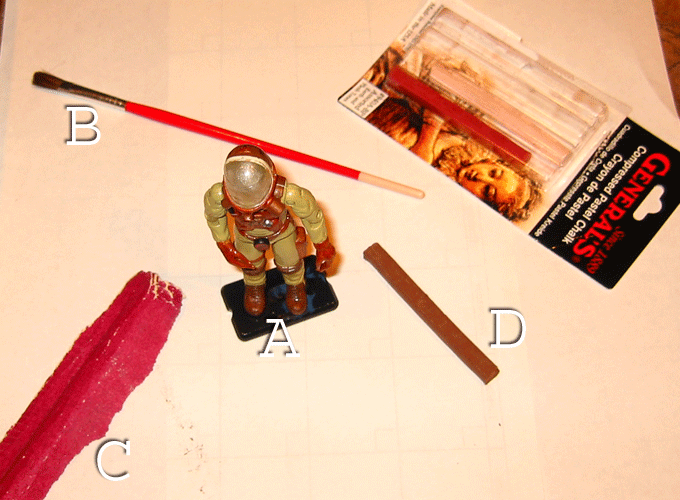

This is my set up:
A. The figure
B. The brush: a soft, full brush (that i've never used) -- make sure it's dry!
C. Sandpaper: in my case, 150 grit
D. The charcoal stick
not shown: paper towel (damp) -- this stuff get on your hands... and everywhere else...
The first thing to do is sand a bunch of the stick into a little pile, as shown here:
The next thing to do is to put some on your brush and then apply it to the figure. I found that it leaves more dust on the figure using 'up' strokes than down strokes, however, this method also releases more particles into the air -- make sure not to sneeze and blow your pile away (yes, this does happen...)
Unfortunately, I couldn't get a shot of me doing any of this step -- but a couple things to note: 1. be careful how much pressure you use on your brush -- too much pressure, especially over an area you're finished with, has a 'dusting' effect -- as in "dusts off" the weathering. 2. if you're unhappy with the results, it's possible to wash the charcoal off and start over -- especially if you sealed the work before starting. Luckily I was happy with the 1st try, because I did not seal the paint before weathering (on this fig -- the other is a different story for another time)

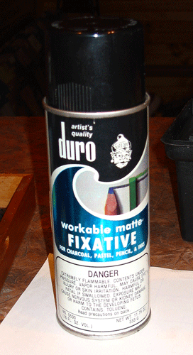

When I was happy with the level of weathering, I used this fixative (made specifically for artists) I don't know if I needed to go with something this special or not -- it doesn't look a whole lot different from any spray-matte finish, except that it doesn't leave an 'orange-peel' finish, and it stinks like the bejeebus. Definitely use outside! But it dries waay fast!

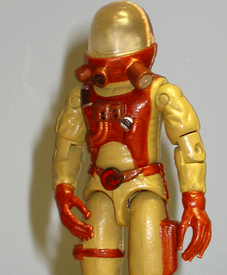

I will reply with a close up of the weathering -- Much more subtle than my attempts at wet-washing, and I will definitely try this again!

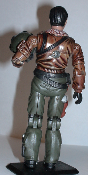

Before:
After:

Inks and drybrushing can do a similiar job, and maybe easier. Something to experiment with if you get bored. Your stuff looks good.
