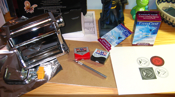

Here was my setup, including: aluminum foil, pasta maker, polymer clay, x-acto knife, paper logos, cardboard cutting surface, and of course, not shown: damp paper towel

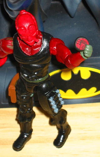

The polymer clay I used was Fimo, from Michaels. I went with basic black, but for the red, I found this clay with glitter in it. Since the buckles on the film versions of the figures were metallic, I thought this clay would add something special. Now, I'm not so sure that it did, but the stuff sure bled red all over my hands...

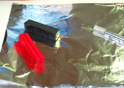

This picture shows the amount of clay I used from each block:

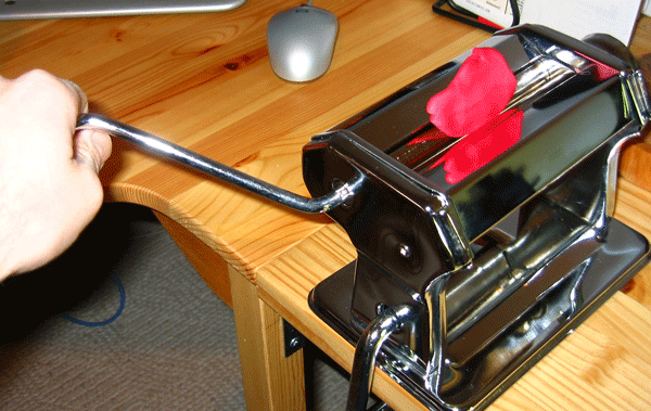

After kneading the chunks into malleable balls, I ran them through the pasta maker, which is just an over-priced machine (IMO) that makes even-thickness pieces. If you're not into beading, or any other clay work, I would guess that a rolling pin or a D-cell battery would do the same... It has different thickness settings between 1 and 9, with 9 being the 'fattest' --
this was done to 7.

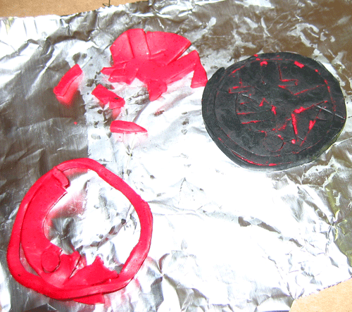

I then sandwiched my clay slabs between aluminum foil, and put my paper logo on top. I then cut through all layers, following all the outlines in the logo -- here's what the top layer looked like:

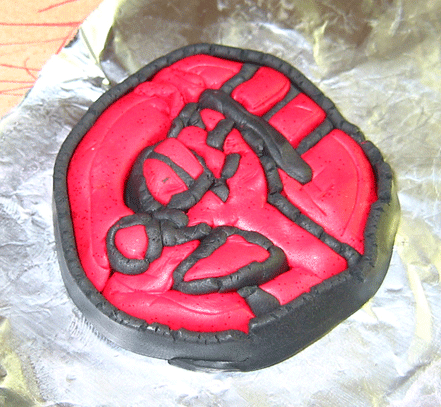

Not too bad... until I tried to unstack all the layers -- this is what i wound up with:
