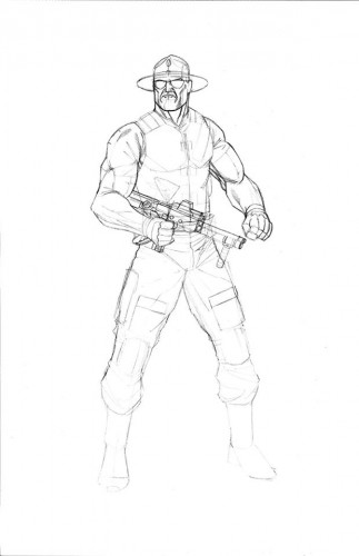

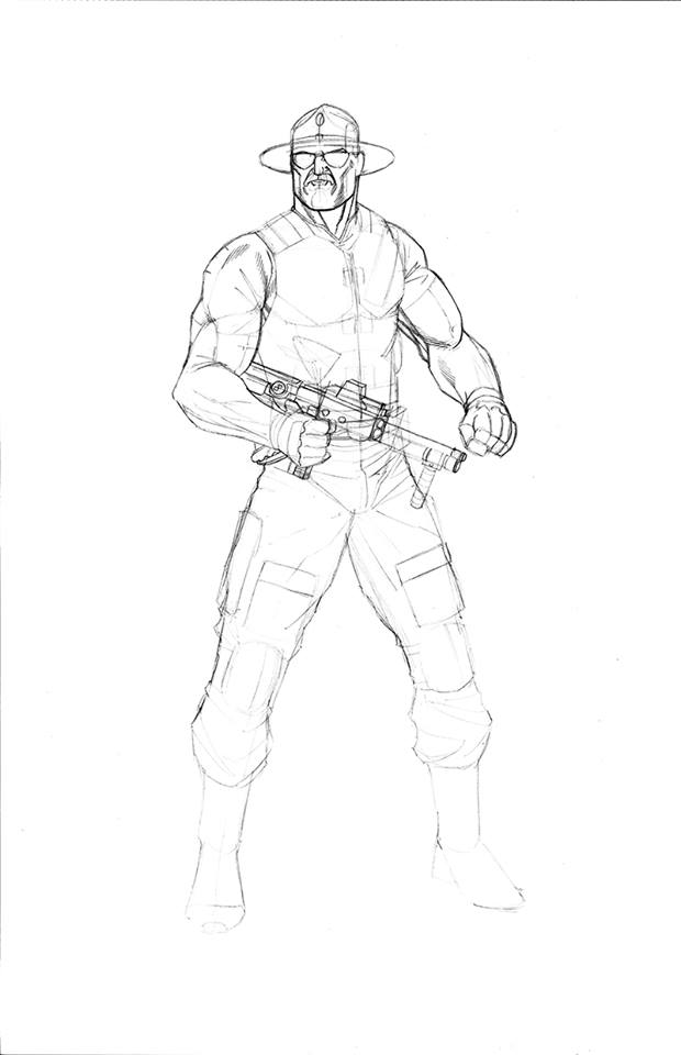

danielb : Meanwhile I sketch out a few poses, usually checking out similar character types card art. Then I usually drawn and ink a drawing twice, once is more a test. the second tend to be something i like better. then water color.
Jm7o : Do you save your first shot drawing, either for posterity or possible future use? What becomes of your final piece?
danielb : Nope I destroy unwanted artwork. The final painting sits in a pull file unless someone wants it.

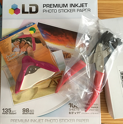

Out of those videos and conversations, I put together my initial shopping list:
Shopping List, Part 1:
Glossy Sticker Paper
Corner Rounder Punch
Tab Punch
Owned resources:

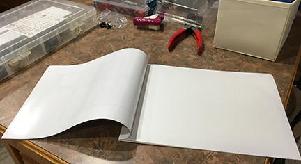

I knew I had some comic book backing boards.
I thought I had a pro-tech case somewhere.
A custom figure.
What I didn’t have? A graphic.

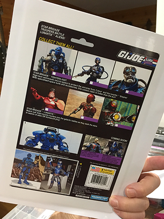

For my project, I didn’t need anything fancy or clever, I just needed something to print. I asked around, and pluv mentioned that back in 2009-2010, Dream had worked up some card templates for his own use, and had saved them to our JC wiki.

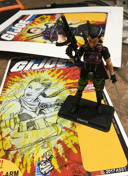

So I began my proof-of-concept:

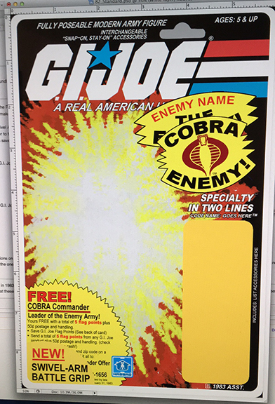

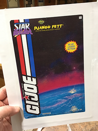

I opened one of the Photoshop Star Brigade templates, fiddled with the text on the front, and spent 20 minutes putting other Blue and Red Lasers on the back. I printed it on my home inkjet printer, gathered my supplies, and went to work.

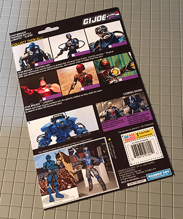

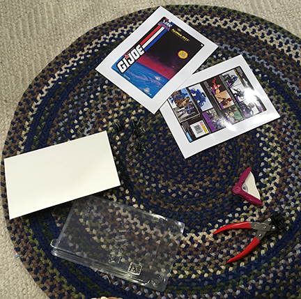

I sandwiched my backer board between my two card images (which were facing out, adhesive side in) and put binder clips along the top edge. I then lined up the papers and put another binder clip on the bottom edge. The goal here was to be able to peel back the backing paper on one side and stick that down without allowing the stacked pages to get off their registration. I hit a snag at this point: because I was using a comic book backer board instead of a magazine backer board, the edges of my adhesive backing on the top layer stuck to the backside of the bottom layer, as the middle layer didn't reach the edges. **Note to use magazine backer boards next time** But I was able to eventually get everything stuck together. As the photo shows, you can see where I had to pull it apart a bit, but it happened outside of my graphic area.

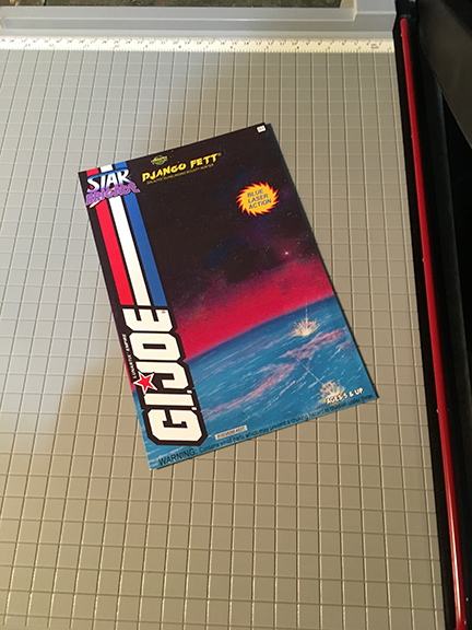

I then took it to my old, trusty, emphasis on old, paper trimmer and cut the card down to size. It was at this point I noticed a couple other things:
1. I didn't like the original trimming of the source file
2. I forgot to graphically fill in the old peg hook hole on the back of the source file
3. I completely understand now why 'experts' in this field are using guillotine-type clamping paper trimmers vs. the old shear-type like I have -- no matter how slow or fast I made my cut, I got 'cut creep' while bringing the blade down. Possibly the blade is just too dull, but I think I will switch cutters next time.

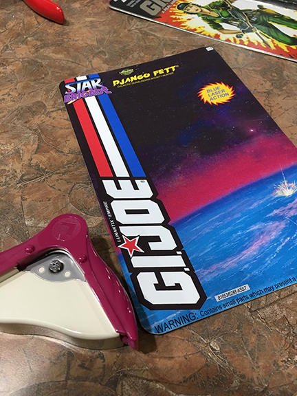

The next step was to round off my corners. I definitely got what I paid for with my corner-cutter. When I tried it out on a blank sheet of paper, it worked perfectly! When I went to cut through my card/paper sandwich, it left a fuzzy edge, but what was worse, it got stuck. I had to disassemble and reassemble the punch after every corner, resetting the blade in place. I think I will be upgrading to the more robust punch as I continue.

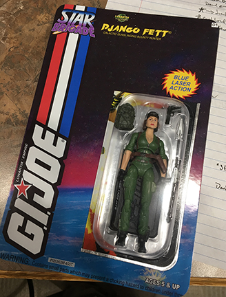

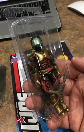

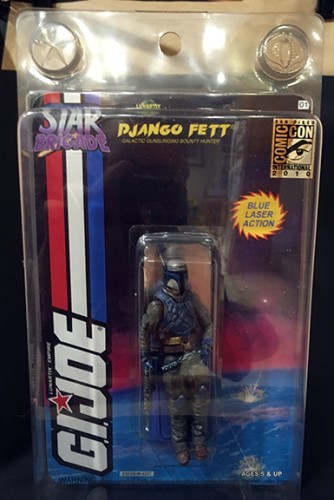

I did a quick test fit of my card back in a Hasbro clamshell. Now I was getting excited.

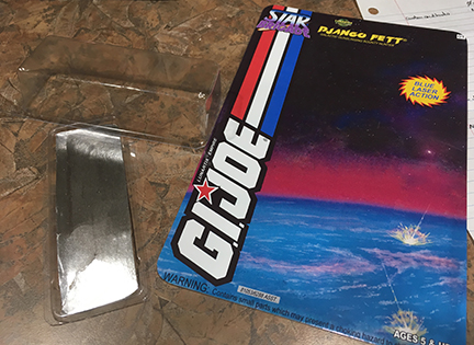

I searched all over for my pro-tech or equivalent case, but since I'm in the process of re-defining my collection, I just couldn't find one anywhere. A carded Lady Jaye was going to have to suffice, even though it meant I wouldn't have the ability to remove my blister from the card without re-gluing it. I moved it around on the card to see where it would work best.

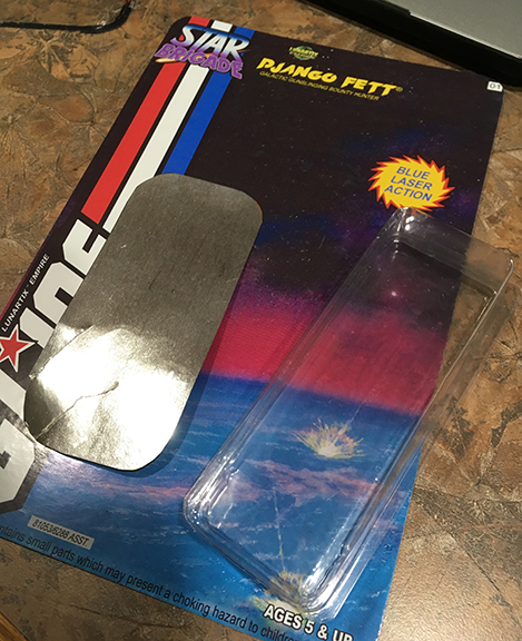

Oh, then I found my pro-tech case.
I cut the top of the case off, including the peg hook hole, then turned it around and cut off the hinge. I rounded the edges while at it, too. I was a little bummed I pulled that Lady Jaye off the card, so I salvaged (mostly) the silver backing from under the blister bubble of her card. It was also at this stage that I used my peg hole punch to punch out well, a peg hole. As you'll see in the next few photos, the guide for my punch didn't line up with the graphics on the card, and certainly not with the visible hole punch from the original scan on the back. I put the punched out piece of cardboard back in the hole I had made ... for that 'unpunched' look.
Remember: the reason to use a pro-tech blister box was so that the back of the box could be glued to the card, and the front of the box could be
friction-fit to be removable and allow for figure display or play. I found this product called Glue Dots for use on another project and realized they seemed exactly like what photo-mounters use in 2-sided glass displays. I used one of these in each corner to hold the back of the pro-tech blister to the card, and put it all together.

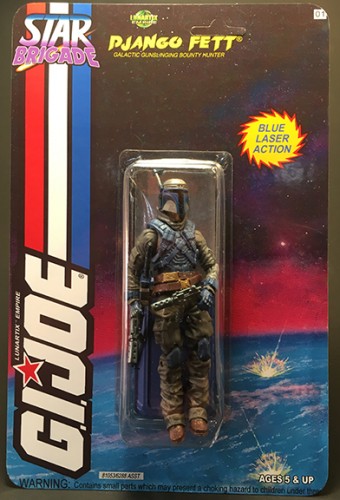

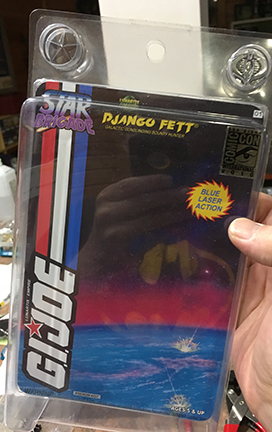

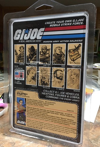

I have done it! Conquered the fear of the unknown! Custom carded figure and with a removable blister bubble! As I held my handiwork at arms' length I realized ... it looked bad.
A few things I learned:
1. The corner rounder I bought does not work for this. Anytime I tried to punch something thicker than a single sheet of paper, the shears jammed and I had to disassemble and reassemble. You get what you pay for.
2. I understand why people use the magazine backing board. Although I don’t have any yet to compare thickness, I can understand why having a backing board the same size as your print is important for lining everything up.
3. I completely understand the idea of a white border/gutter/bleed eliminator. Also I understand why people recommend the guillotine paper cutter. My old ‘normal’ paper cutter had a serious cut ‘creep,’ no matter how slow or fast I brought the blade down.

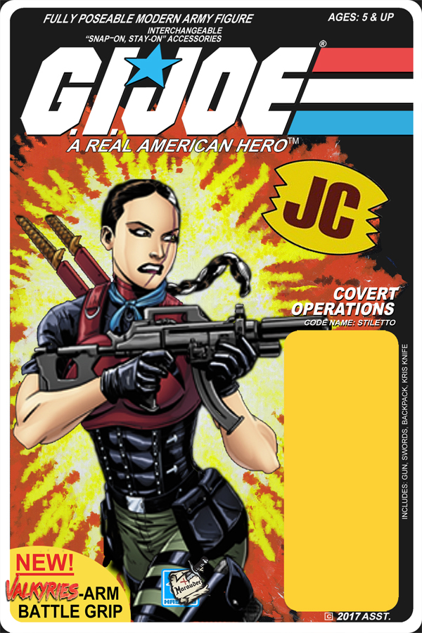

While I was looking for a template to use for my proof of concept, I thought about one of my besties; a guy who certainly has some experience with package design and layout: James "KuuKuuSon" Kavanaugh, Jr!

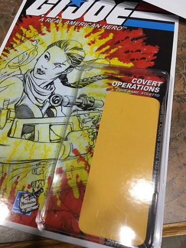

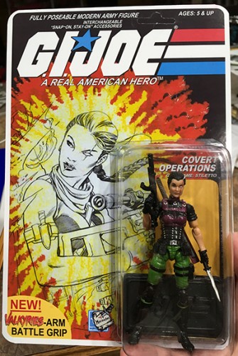

Time to implement ...
Shopping List, Part 2:
More robust corner punch
Brayer (help lay the sticker down permanently)
Magazine size backer boards

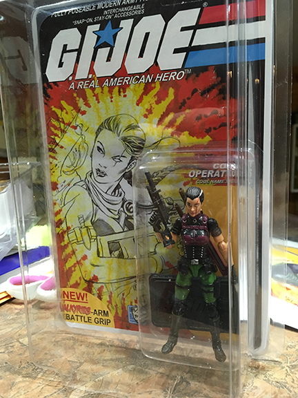

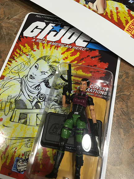

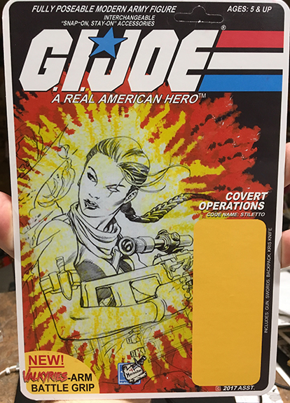

I decided to use my recently-completed Stiletto custom (that used the recently-released MTF Valkyrie parts)
I spent quite a bit more time in Photoshop putting this card together, including trying two different designs for the front, one with scanned Hasbro packaging artwork, and the other using Robert Atkins' Kindle Worlds pencil sketches. I used the basic Joe card art from the wiki as a base. I conducted an informal poll with some buddies, and decided to go with the Atkins sketch on the front, with some additional MTF design elements for fun:
For the back, I used the other Atkins Kindle World figure sketches, as well as duo-tone Hasbro recent releases and Marauder's Logo in the upper part, and information from the Hasbro Stiletto card and a quote from General Hawk's review of Stiletto from GeneralsJoes for the file card. Eagle-eyed fans might find a few other Easter eggs on the card back as well ... :tictoc: :
And here they are all applied to magazine backer board, trimmed, and punched:
Ooops... I had used the original card template, which is sized for a regular joe-size blister bubble ... not the bubble that I actually had on hand ...
Although it didn't look too bad, it was not what I was hoping for. On top of that, this new bubble was too 'deep' to fit in the standard Hasbro GI Joe clamshell, and I had to go with a bigger/deeper 'Star Card' bubble.
But hey! From the back, you can't tell anything is wrong!
Lesson learned: make sure you know what you're designing towards before actually printing the image, have the actual physical pieces to measure against.

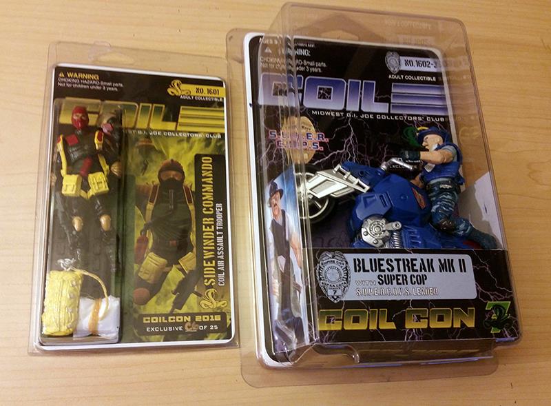

In conjunction with the above article, I talked with John Jett, hot off heels of the reveals of his artwork for this past year's Coil Con 7. So if you wanted any insight into drawing/designing your own art for your custom cardback, he offers some great advice.
pluv: How did you get pulled into the CoilCon project?
John Jett: I got pulled in the same way I typically do with these type of projects. Another more talented artist was supposed to work on it and stepped aside, recommending me to the Coil crew. Andrew Hall has done card art previously for Coil Con, among others, and it was just good fortune for me that he was otherwise occupied in an undisclosed Guatemalan detention facility. I tend to get similar work every time Andrew goes on "vacation".
Awesome.
pluv: Can you take us through your process? Where do you start? Are you working in a specific medium or program? How did you determine the pose?

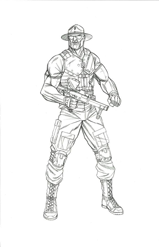

John Jett: I start off every project by making sure that I know exactly what the client is expecting as a final deliverable. In this case, getting them to send me examples of previous sets was important so that I could match the tone and feel that everyone associates with classic G.I. Joe packaging art. It was also essential to start out with as much reference for the figures and accessories as possible for the sake of accuracy. With two of the three pieces, they had a specific pose that they were looking for. The Sidewinder Commando has a mirrored pose to the Freefall card art since he's the Coil equivalent of the Joe's paratrooper. He even has a little buddy in the background, just like Freefall. It was a cool little nod that they came up with that fit the character perfectly.
The process for each piece is based on getting feedback and approval from the client at each stage. The sketch and finished pencils are done traditionally on 11x17 bristol paper before completing the colored art in Photoshop with a Wacom tablet. With the sketch, I'm focused on working out the pose and proportions of the character. Even though it's not really seen in the final product, in many ways it's the most important step in the process. It can be a challenge trying to capture the energy that shows up in the sketch in the subsequent steps.
For me, the finished pencils are where I have the most fun. This is where I usually get to work out light sources, add details, and stylize the drawing. With the packaging art that I've done, even the penciled art basically serves as notes and reference for the final colored piece since it gets painted over in Photoshop. Oddly enough, the coloring stage doesn't start off in color at all. I work out a tonal piece in grey first. Once I feel set with the tonal values, I digitally paint the art in full color. It's at this stage that I finally get to paint in either the classic Joe explosion or one of the electric fire backgrounds that the CoilCon exclusives use.
Throughout the process, I stay in contact with the designer, in this case James Kavanaugh, Jr., to make sure that the final art piece will meet their specs. I double as a Graphic Designer professionally, so it helps the finished product to speak the same language as the client or the team. The job isn't done until it's been printed and assembled, so making sure that my part is print-ready is key. Plus, James is way bigger than me and a wild man to boot. I can't imagine what he would do if I sent him final art files that he couldn't use.
