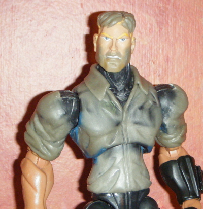

Here's a WIP I'm using Aves on, which is the gray stuff. I've done absolutely no sanding or dremeling at this point and the only sanding I anticipate is a couple of spots where it blends into the plastic at the shoulder joint and I didn't get it quite smooth enough.
