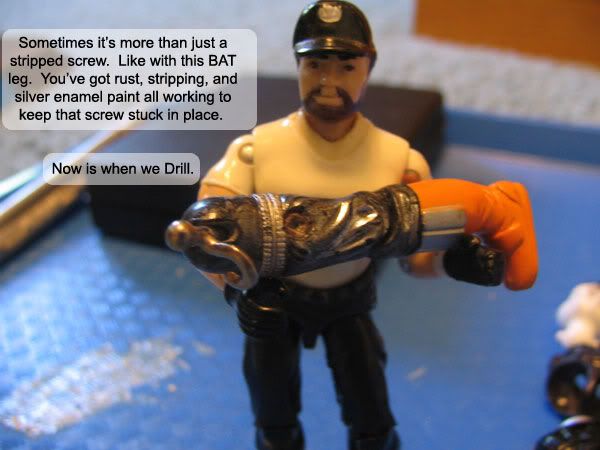

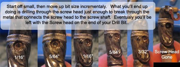

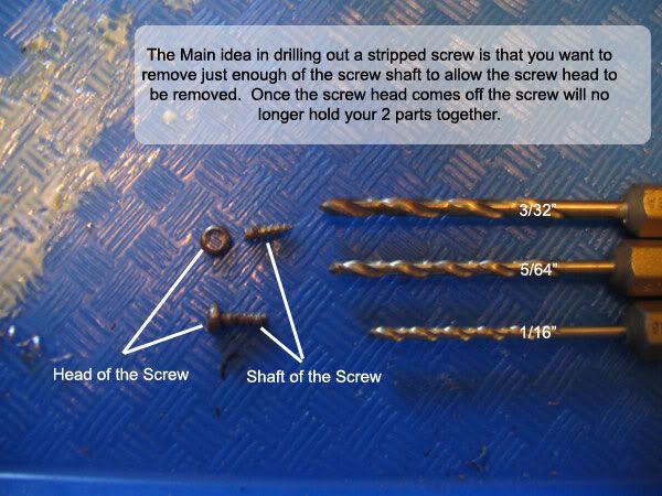

Does anyone have any tips on removing stripped screws? I checked out the guide (http://wiki.joecustoms.com/wiki/Remove_a_Screw) but unfortunately most of the pictures that show up on my computer are the comedic intro and not the actual nuts and bolts of the opperation.

Python Viper wrote:
Yeah, you are going to need a dremel. But be careful about overheating the screw, it will melt the surrounding plastic. I fill a sink with a few inches of water and hold the part just under the surface as I drill out the screw. The water dissapates the heat so your part wont melt.
