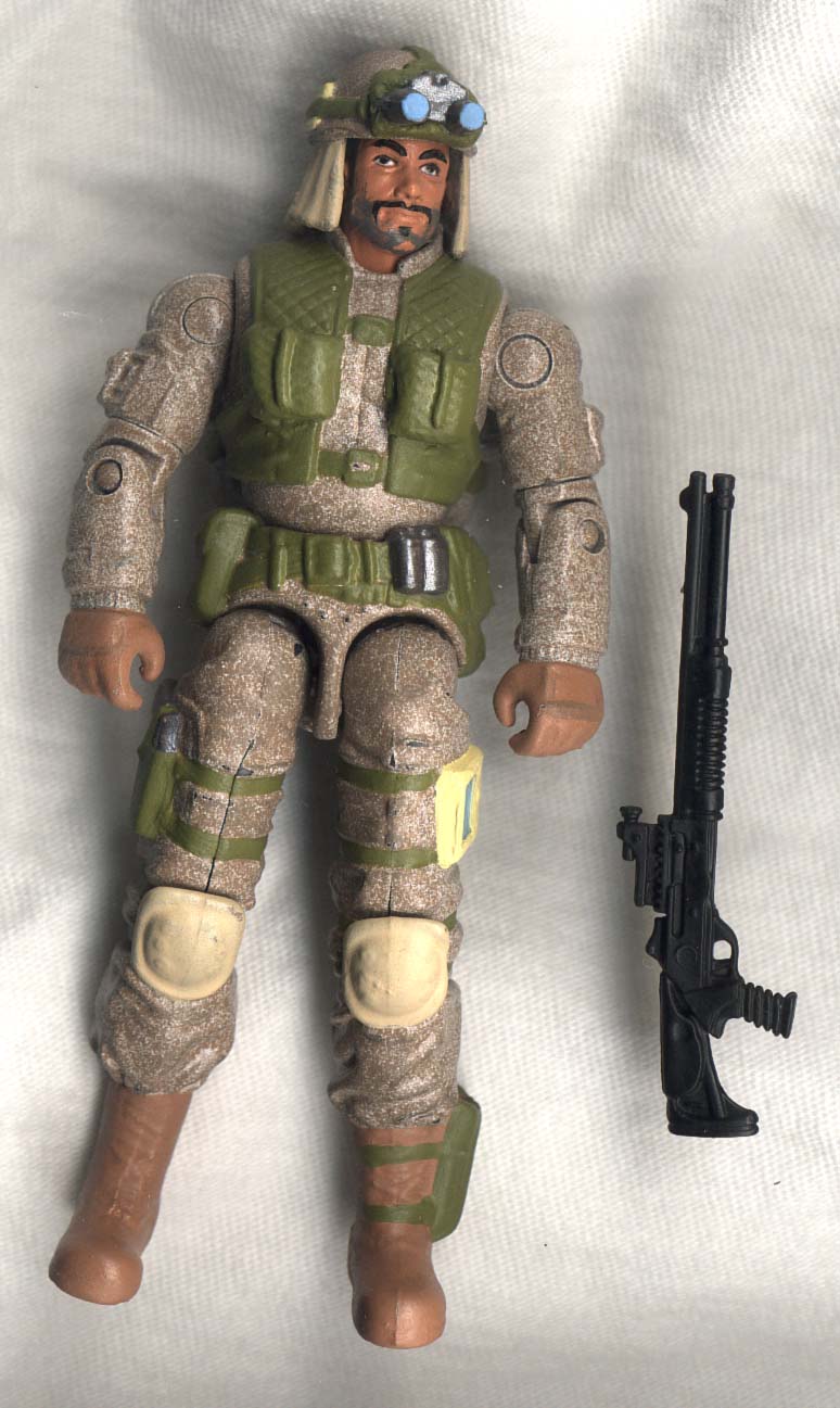

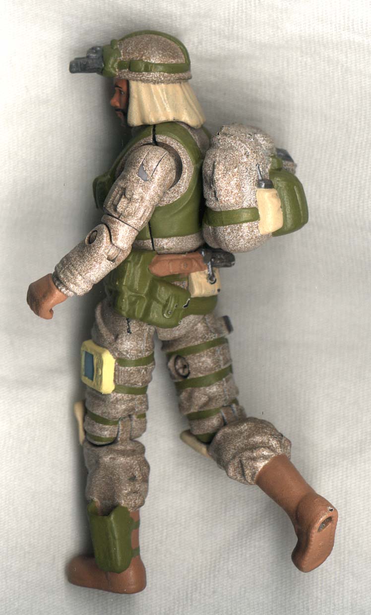

Claymore was always a character that I never understood the popularity of. Somehow, no one cared that his uniform was banana yellow. Sure it, had dark spots (like a rotting banana) and a green vest (not like a banana), but it always seemed a bit silly to me.
With a few extra NS Tele-Vipers lying in the parts bin, I broke down and had to make a Claymore figure.
The only NS helmet I had to work with was the Dusty helmet, which I don't care for. However, that was the only option. To make it look less like Dusty's helmet, I added the night vision system and the top strap.
Throwing the Tele-viper's shoulder-mounted radio gear on the vest might have looked good, but I wanted to step away from the obvious source of the chest. I instead sculpted the cargo pockets on the vest. I also sculpted the backpack's back-facing side so that it contours better with the figure's shape.
A desert color scheme was the most obvious choice. The green is pretty much a perfect match for the original. As much as I don't like the color, I also used the banana yellow sparingly on some details- little box on helmet and the computer on the leg.
Parts:
Head- NS SAW Viper
Chest- NS Tele-Viper
Arms- NS Ace
Waist- NS Snake-Eyes (the one used for the Plague figures)
Legs- NS Snake-Eyes (the one that came with Timber)

 Post subject: Re: Claymore NS
PostPosted: Fri Apr 11, 2008 11:28 am
Location: Niagara Region
Wow! Can you share how you did that paint job?
PostPosted: Fri Apr 11, 2008 11:29 am
Great paint aps!
PostPosted: Fri Apr 11, 2008 11:42 am
Joined: Tue Nov 06, 2007 12:52 pm
Location: France
Great custom! I was gonna ask about the paint job too but Devilfish beat me to it. It looks incredibly nice and production-quality!
I like bananas too.
PostPosted: Fri Apr 11, 2008 12:14 pm
I'm going to guess that he used textured spray paint. Regardless of how it was down the overall effect is awesome. The parts work well. The accessories fit the character. And the paint is good. All around high score from me.
