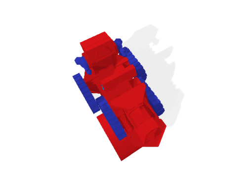

I'm a big fan of the Mega Construx figures, especially the MOTU characters they're making. I'm not a fan of brick-builds, though. So I've decided to make some of my favorite vehicles and accessories in a non-brick format. First up, is the Attak Trak. This was the first MOTU vehicle I got and it burned through quite a few C-cell batteries racing across the house and front yard when I was a kid. This one won't be battery powered but I tried to make it as close to the original as I could. I don't have the original handy to take measurements and such from so I based it off pics I could find online. Because of this, the scale and some detail will not be exact but it's good enough for me.

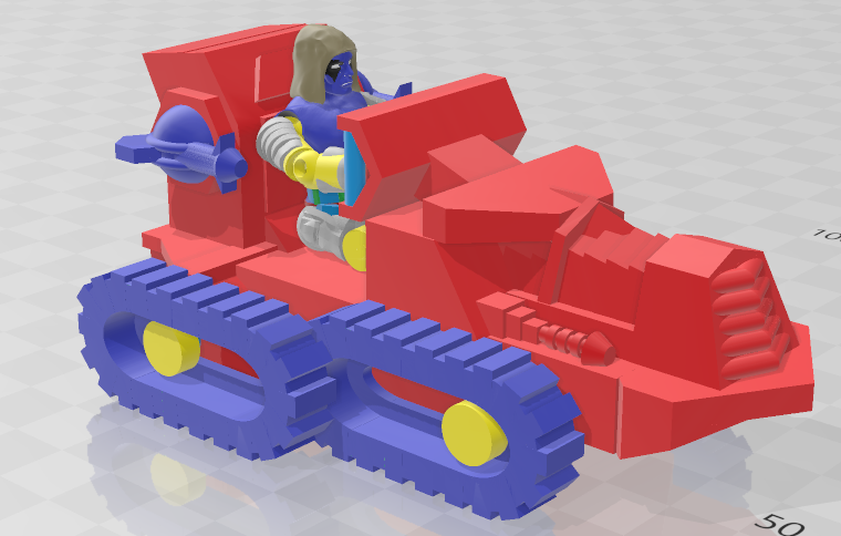

Here it is with a Mega Construx character I had previously designed and printed out, so I knew it would at least be the right size for the figures, even if some of my specific parts were not the right size.
Here's a top-down view of it.

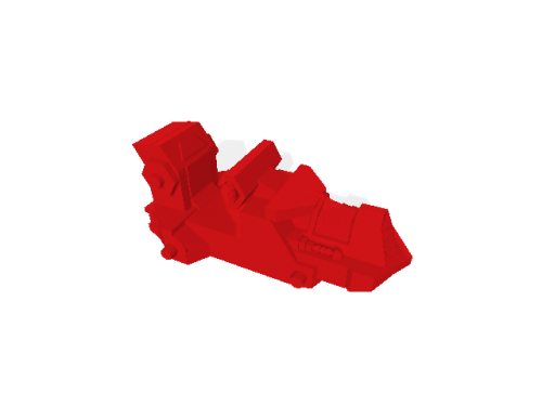

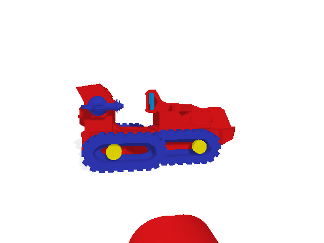

Here's a side view of it.

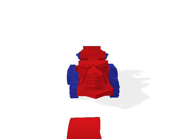

A couple more pics:

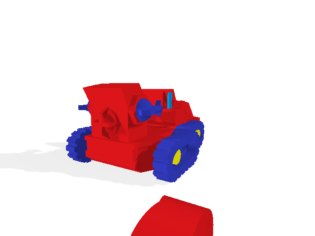

Here's a view of it from the front.

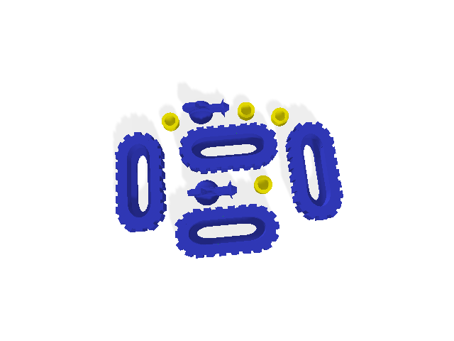

I loaded the model into MS' 3DBuilder -- actually a pretty good light duty program for doing some basic 3D design and model adjustment. I split the model into two files: the tracks and guns and then the main body:
I positioned the parts so that I knew they would fit on my print bed. I'm running these off on my smaller printer, which only has a bed size of about 4"x4", so I had to arrange them in a 100mm x 100mm square.

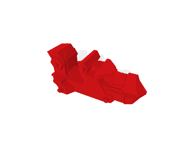

The body didn't need any adjustments in 3DBuilder. Since it's a single piece, I can drop it in Cura (the software that converts my 3D models into instructions for the 3D printer) and position it there. I'll show that in my next post.

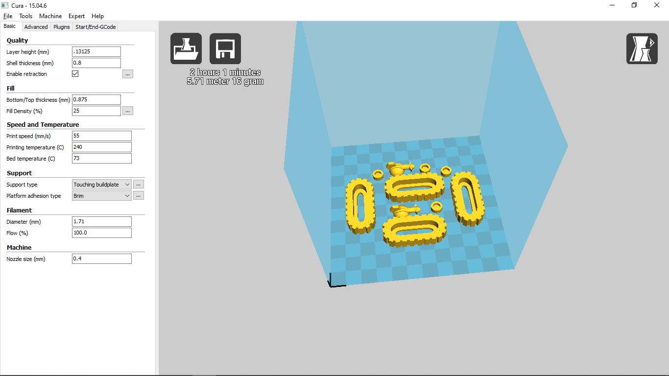

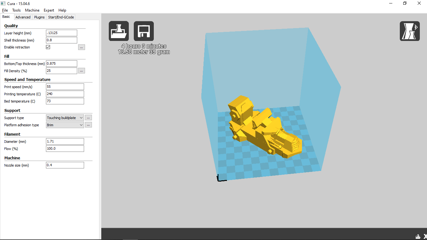

Now that I have the parts separated out so I can print all the blue parts at once and then the red ones at ones, it's ready to start slicing. Slicing is the process of converting the 3D model into a series of commands, handling 1 layer at a time (thus the slicing) of building the model. Depending on the print quality you go for, this time will vary. One thing about Cura is that it will give you a predicted time for how long it thinks a print will take. This is a filthy lie. It always takes about 30% longer than it predicts.
Here are the tracks and guns positioned on the print bed mock-up in Cura, along with all the settings I can configure for the print job. These are the standard settings I use for the printer I'm using for this. The layer height is the one that controls the quality of the print the most. Adjusting to a smaller number means that the layers will be smaller and therefore less noticeable. This also increases the print time. I have it set at ~.13mm. When I have this printer really dialed in, I can go down to ~.04 but the print jobs take forever. I usually do ~.08, which gives a nice result. For test prints, I'll do ~.13 or ~.18 -- they give a good result without being too slow. Anything larger than that and the layers become too noticeable and make it hard to tell how some of the detail actually looks.
I turned the body about 45 degrees to get it to better fit on the print bed. It would have just fit turned straight on, but there's less of a chance of it messing up at the edges this way.
