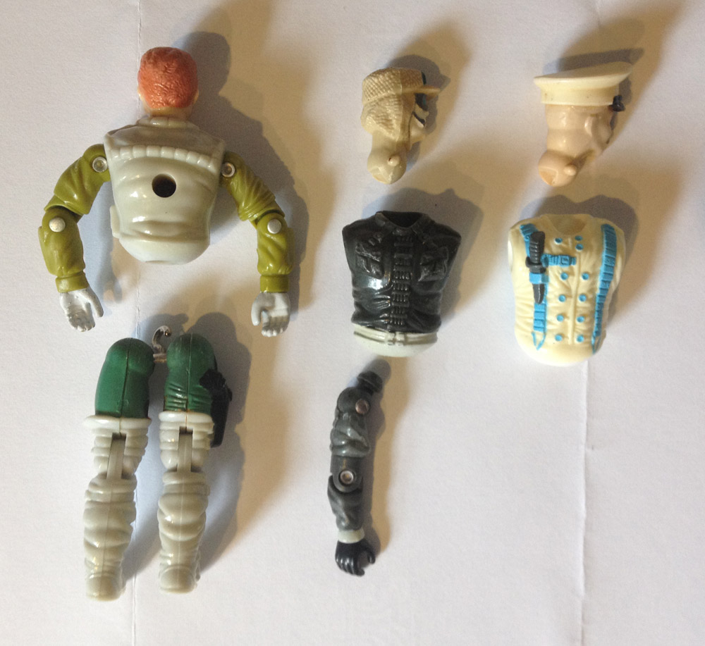

Author:  Matthew [ Sat Sep 06, 2014 9:34 am ]
Post subject:  Re: Removing yellow staining
1 cup of water to 1 tablespoon of OxyClean. Set out in the sun for roughly a week. I would shake up the solution daily.
Before
After
Still some yellowing, but definitely see improvement. Seems like Long Range's hair has changed color, but it looks to be the only paint affected. Next I will try OxyClean and cheap-o Peroxide.
