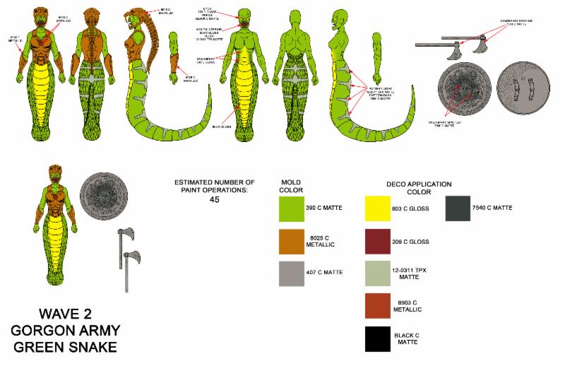

So, I was watching Boss Fight release photos of the Gorgon Army: Green Snake, and was really struck by how good that copper color was looking, for being hand painted -
I reached out to Erik Araña with some questions, and he was kind enough to respond:
Jm7o wrote:
Erik - who is painting the Green Snake Gorgon?
Erik Araña wrote:
Me
Jm7o wrote:
what brand of paint is that copper? and yellow?
Erik Araña wrote:
I just finished her (aside from some touch up after assembling her) and will do the Underworld Spartan tomorrow
I use exclusively Vallejo Model Color now
The yellow of the eyes is from the bottle but the underbelly of the tail is mixed
The copper has a leather brown/orange clay color underneath it. It helps gold or copper pop

45 Paint Applications!

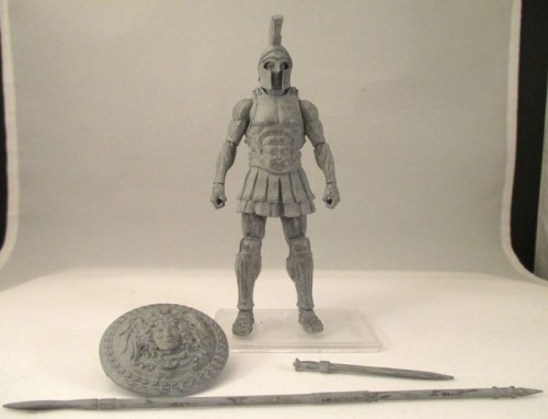

Painting Lessons with Erik, Part II:
Jm7o wrote:
Erik - can I break you away from painting your underworld warrior long enough to ask how you achieved such a great looking stone finish on the Stone Spartan and various accessories?
Erik Araña wrote:
Yes...
but only for a minute
They are a flat grey with a mid tone dry brush on parts and then a spatter effect using a toothbrush.
in dark grey
mind you...I've got my fingers crossed that they can pull it off in production and the effect might be turn out somewhat different. But we'll try to keep it close
Jm7o wrote:
that's awesome! one clarification: the grey that you're drybrushing with "mid tone" -- is that darker or lighter than your base coat? I can't quite tell from the photo if the drybrush is the lighter or darker shade -
Erik Araña wrote:
darker then the base coat.
base-coat- light grey
drybrush- Mid-Grey
spatter- Dark grey
Thanks for the tips, Erik!
